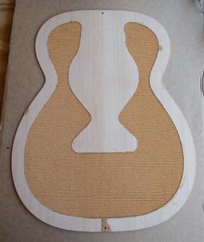

Thanks, Hesh, for the tutorial on how to upload photos. I hope these help clarify how we made and braced our double-top.
Here is a close-up of Nomex, for those who have never seen it. The material looks like wood shavings lightly coated with epoxy.
Here the middle layer of cedar and Nomex are mounted on the interior sitka spruce 'plate'. The cedar was quartersawn, but not bookmatched. The show face is Engelmann, which we used because it is a handsome top set. The guitar is a 000.

"Because the Nomex has no grain structure, it is equally flexible in all directions."
Larry, this statement is not true. All hexagonal honeycomb is stiffer in the ribbon direction, that is the direction the sheets were stacked up in when building the block of honeycomb.
You can easily verify this by flexing some honeycomb. It will flex better in one direction than the other. And believe it or not this will translate into the panel/top. So you can make even a better top by paying attention to this.
It's a small difference when compared to wood, but you may as take advantage of it since it's there.

I think I see what you mean. If I pull the honeycomb along the 3 sides of the hex, it seems to stretch a bit more easily than in the 2 sided direction.
You are correct.
Fortunately, the Nomex from LMI was cut so that it was only possible to get a 000 shape with the stronger axis running in the direction of the grain. (I just checked!)
